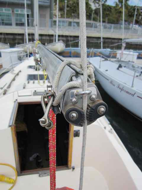

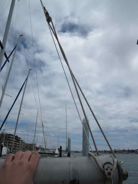

here's an example
topping lift.jpg (19.42 KiB) Visad 23658 gånger
the wire with the block is attached at the top of the mast just 10 cm below the masthead using a 2 screw clip blacket. admittedly, the screws made removing the masthead for antenna wiring more difficult. on end of the lifting line is tired to a clip on the side of the boom using a stopper knot, the other end runs through the an eye and jammer. make sure there is a stopper knot at this end as well.

This is interesting solution. Thanks for the photos.
