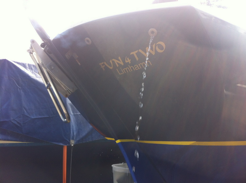

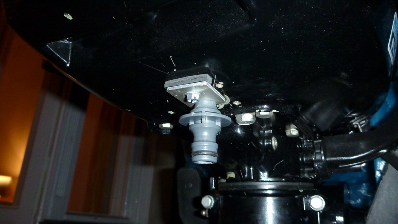

Here are some photos
You can see at the back of the boot (she is now in Berlin) the control jet water running (right) an the exhaust fume (left).
The control jet fitting is a garden hose fitting which has been widen to fit on the outlet (11 mm diameter) and is hold in place with a metal plate and a screw.
The 2 exhaust fittings have been glued with some kind of metal cement like this one (http://www.loctiteproducts.com/p/epxy_m ... ncrete.htm). They join in a single transparent plastic tube connected to the hull outlet.
Exhaust fumes are not very hot, most of it is expelled through the propeller, the upper exhaust is just for idle, when the pressure of exhaust gas is not sufficient to push it through water. Thus a normal plastic hose is OK.
I have head of a german sailor who joined the three tube together so there is only one outlet on the external hull for exhaust gas and cooling water. It might be worst testing.
